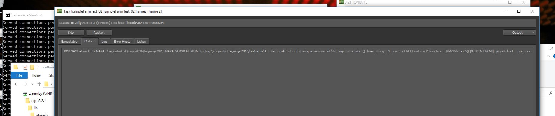

Output window should show output as listing rather than all text in one single line...
See attached for explanation:
Have you seen this Timur?
This is a new install. Our previous (pre 2.2) install would list correctly..

Since 2.2.0 AfWatch begin to colorize task output (errors, warnings, and any custom that you can write in Python).
It parse output data with Python Parser class.
https://github.com/CGRU/cgru/blob/maste ... er.py#L190
Insets html tags to data.
Then users QTextEdit::setHtml function to display it.
https://github.com/CGRU/cgru/blob/maste ... k.cpp#L542
HTML new line is <br> tag.
May be some parsing error causes <br> missing?
Can you test parser toHTML function somehow?
May be there is some fail with your data?

thanks Timur,
I feel like the problem could be before that?

We're seeing the same thing, but only if the job is submitted with a parser that does not exist on the client running afwatch (in our case a custom parser for fumefx sims through maya). If it has the parser it displays correctly.

Try just to ensure that afwatch imports a service and parser Python classes correctly (check that such classes exit at first).
This way you will find out that the situation above it yours.
If so, you can tell me linux distribution to build.
