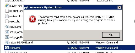

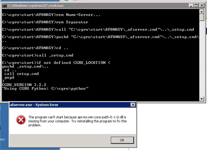

I have a similar issue.
Trying to execute afserver on WinServer got this error
If i execute start.cmd
pythonw.exe - System Error.jpg (33.2 KiB) Viewed 39079 times
When execute afserver
Which Visual C++ Redistributable Packages install solve this missing dll error adding api-ms-win-core-path-l1-1-0.dll ?
i was trying to copy some api-ms-win-core-path-l1-1-0.dll (32 and 64) downloaded from inet to system32 with no luck
Any help is very welcome

Re: Pyton34.dll missing
Strange. It starts fine on all tested fresh MS Windows systems.
Try to dig other internet on api-ms-win-core-path-l1-1-0.dll missing.
* pay attention that the last number is 0, not 1.

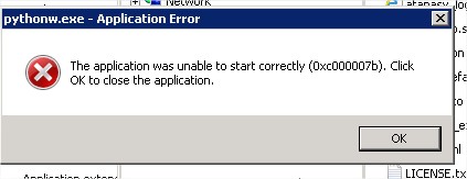

When i install it manually
pythonw.exe - Application Error.jpg (15.73 KiB) Viewed 39072 times
Most probably that dll file you have found is "bad"\not suitable for your system.
Try to ask\find this issue on some MS Windows specific resources.
There is no windows admins reading this forum.
I am not using windows anywhere.
