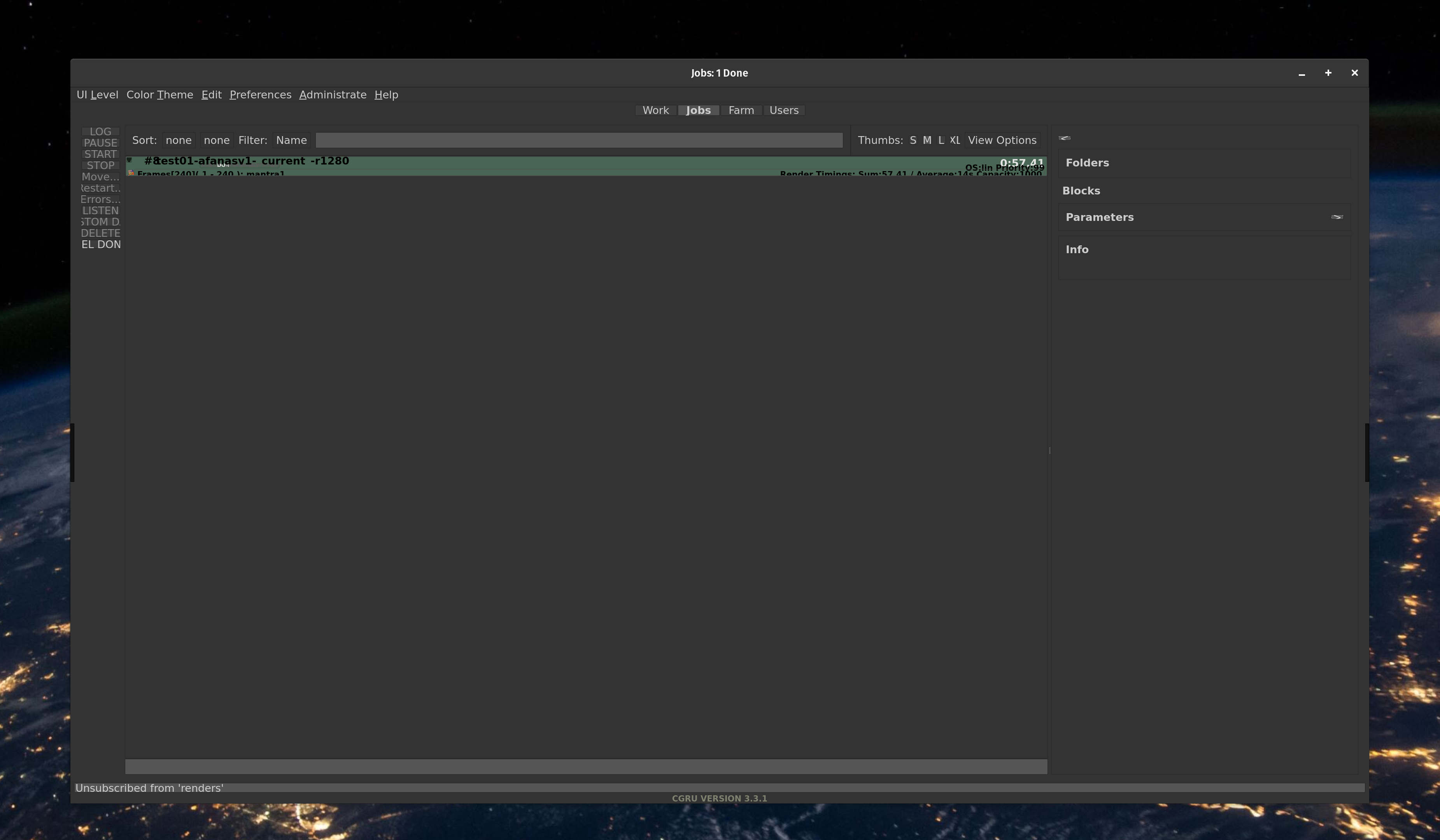

In Ubuntu 20.04 if you set UI scaling in system Display settings, the Watch GUI is nor scaling properly. Some elements overlap.

Try to set QT_AUTO_SCREEN_SCALE_FACTOR=1 environmet variable.

Re: UI scaling
Post by vfxgeek »
Yep, that solves it!

Re: UI scaling
Post by frantejo »
hello I have similar issue in pop_os 22.04, I already set the environmnet variable but the issue is still there, I am using 4K monitors
