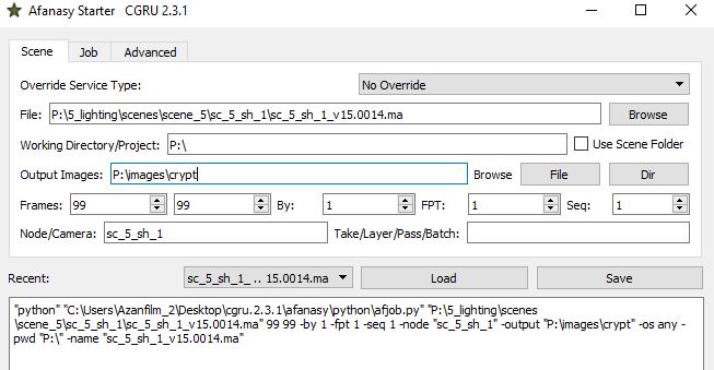

Hello,
I have several rendering nodes. All of them except one put rendered files to the place which i specified in Afanasy "submit job" window.
One of them puts rendered images in the "images" folder of the default project. I don't really understand why it happens and not sure how to start tackling this issue.
I attached the executed command from afanasy
https://pastebin.pl/view/a3af756d render log from maya
I use cgru on all nodes 2.3.1
Maya 2019
Thanks!
This is how the command looks before i submit it
Re: One of the slaves does not put rendered images in the folder specified
You are asking why the same command works as expected on all machines except one.
Check Maya settings on that machine.
You can also (better) ask this question on Maya forums.
As it is not an Afanasy related question, you can not no mention it:
" - Running this command all machines works fine except one."
