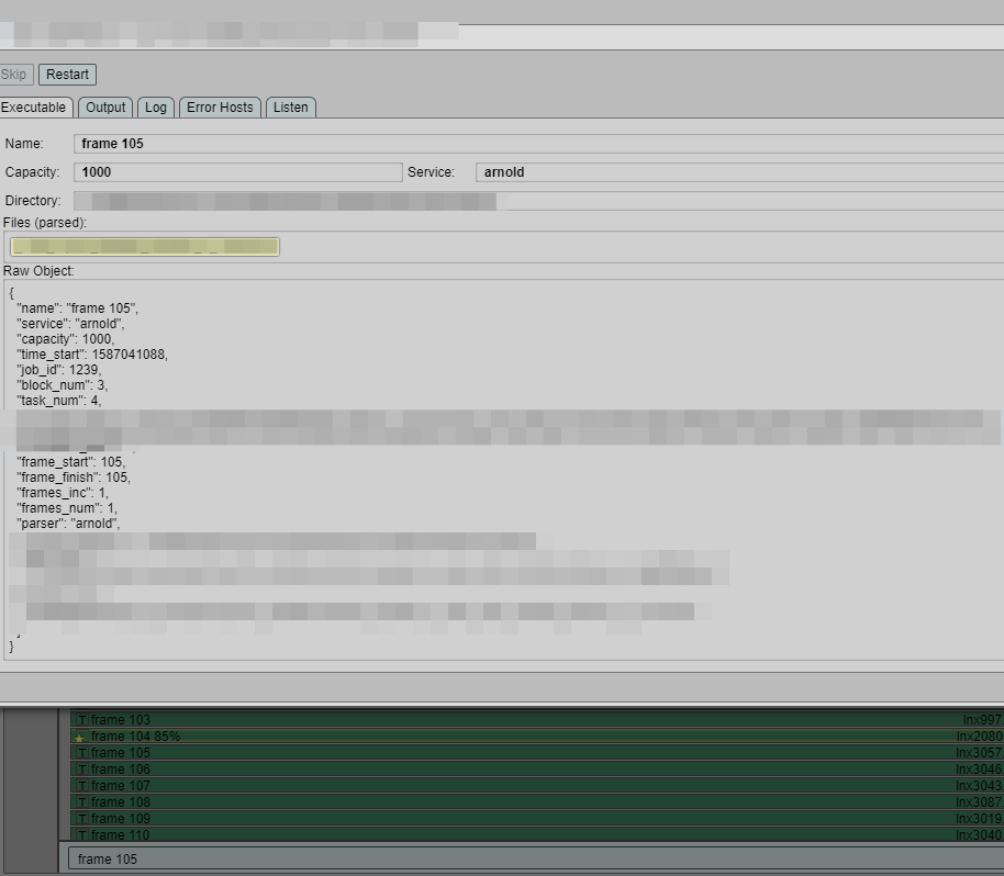

Sorry, I do not get the information I wanted.
I try request with block_id and task_id, but result is empty. I looked at the net-monitor.
If i use only block_id, i get result (i get info only about tasks_num, tasks_name, etc). task_id doesn’t affect anything.
How to get complete information about a specific task?
Re: JSON Request for task
You can open it in GUI and see logs.

I need to see task through python.
Server has only JSON API. Python module (API) just helps you to construct a valid JSON objects.
