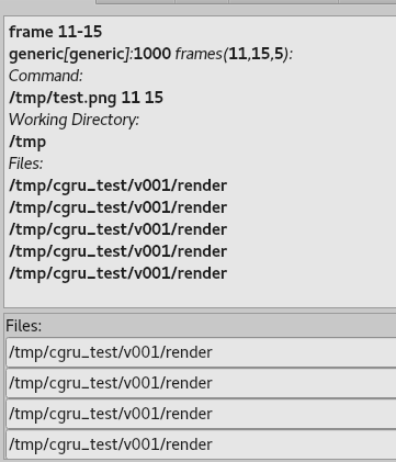

Hello,
In cgru version 2.3.1 block.setFiles([file Path]), files is showing 'frame per task' times on the block level.

Sorry, i did not got you.
What showing? Some GUI? What GUI? What is the "block level"?

Re: block.setFiles issue
Hello,
Please find attachment.
Thanks,
Nilesh.
Thanks,
Nilesh.
This is a normal behavior.
af.Block.setFiles function assumes some numeric pattern to be various for each frame.
http://cgru.info/afanasy/job#block_files
