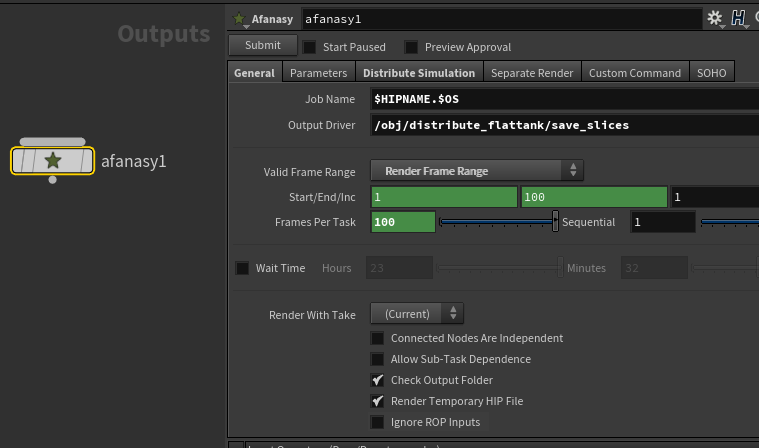

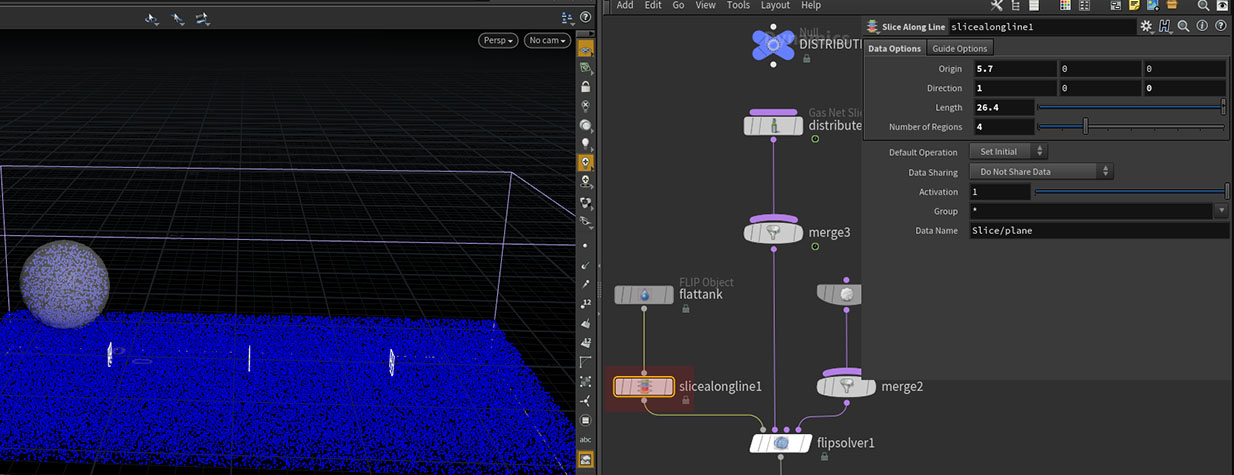

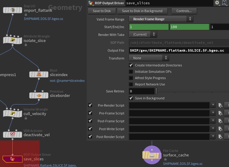

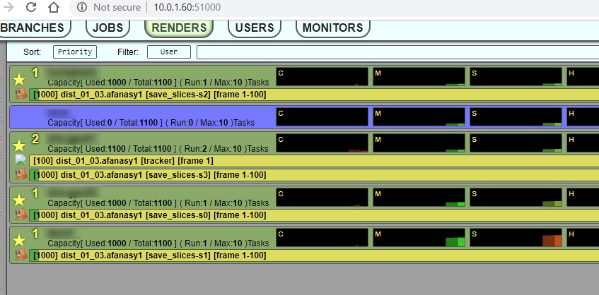

Hi guys,
I'm trying to understand how can I use Afanasy for distributed simulations.
I create a particle sim scene with slices. Sending it to the farm and everything looks right but for some reason it stopping after first frame of simulation.
No errors, just have no progress.
Some one can help me to setup it in correct way please?
Im using Win10 Houdini 16.5 Afaniasy 2.3.1
Link to scene file:
https://www.dropbox.com/s/lpwiu8di2a9lg ... 3.hip?dl=0

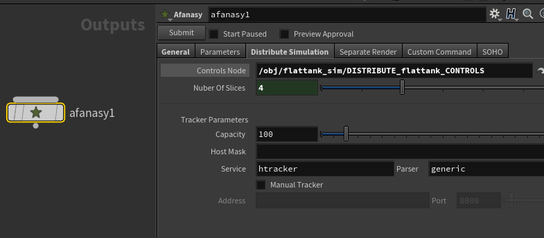

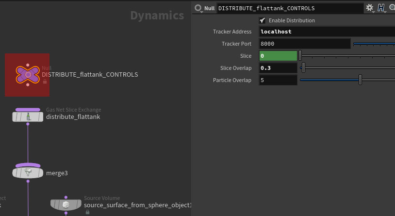

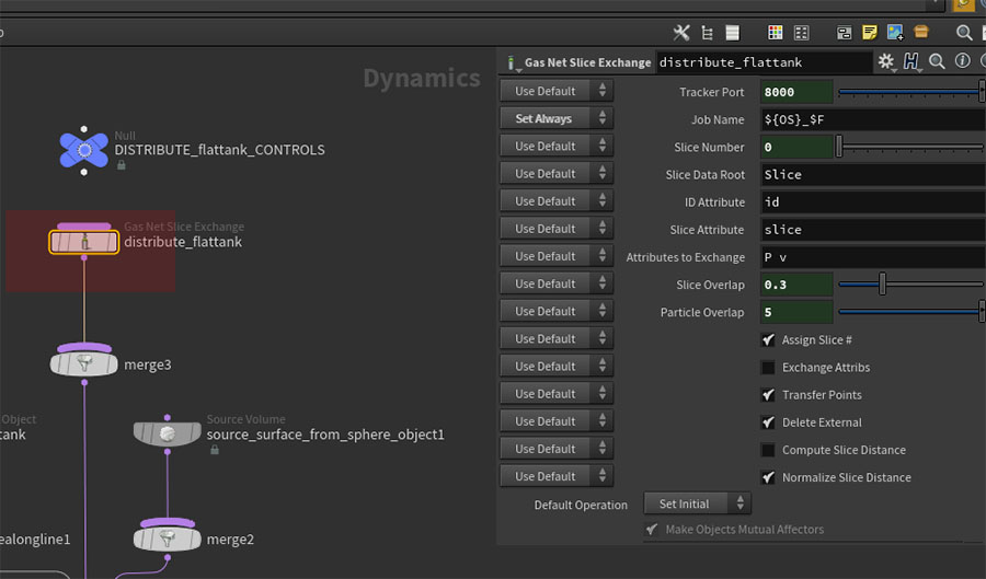

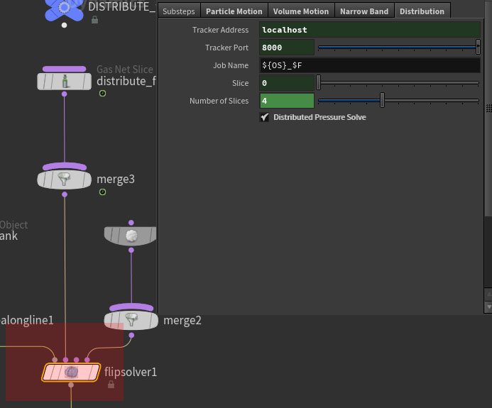

Could be possible what problem is port address?
For some reason in log and in properties tracker ports are different

Long time with no answer...
I think this is because distributed simulation is a most complex theme.
There can be lots of reasons that it does not work.
"I'm trying to understand how can I use Afanasy for distributed simulations."
- the same as HQueue.
When Houdini computes the same (sliced) simulation on a different machines it uses Tracker to find each other.
Tracker is a server written python script with a web gui for logs.
Afanasy and HQueue does the same:
- Run Tracker server and store its address and port
- Run hython for each slice, open scene. Set $SLICE variable and and tell control node where to find Tracker:Port.
- Stop Tracker server.
So initial address and port that is set in a control node does not play any role in this case.
To debug some problem scene you can do the same manually, w/o any render manager.
- Run Tracker manually.
- Open several Houdini applications and open you scene (same scene) in each (no matter on the same machine or not).
- Set $SLICE variable on each Houdini instance (0,1,2,...).
- Set Tracker address and port in a control node.
- Push "Play" button.
Scene should play on all machines. You can use Tracker Web GUI for logs.
