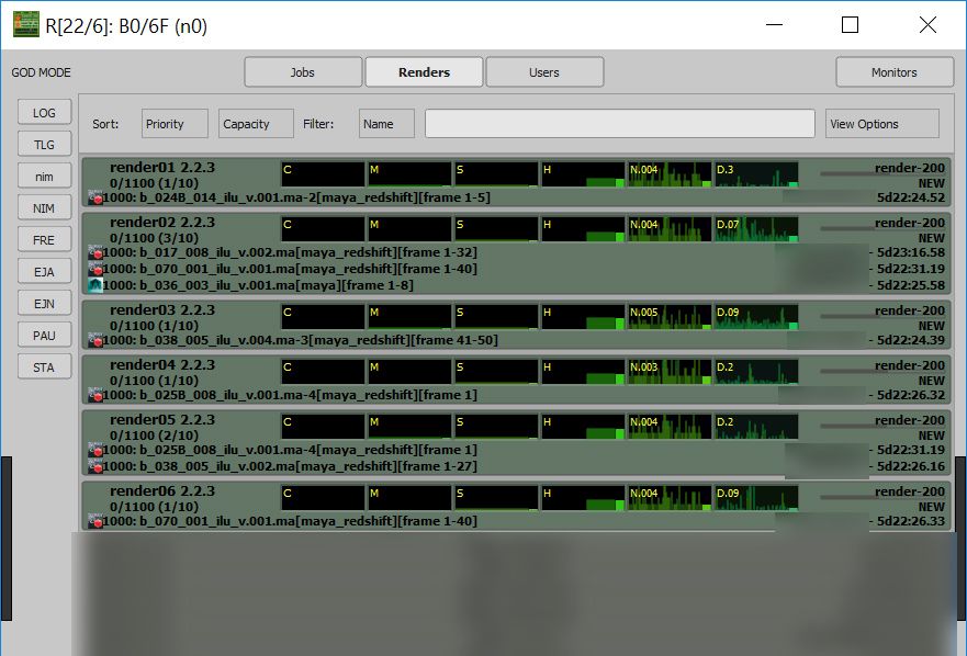

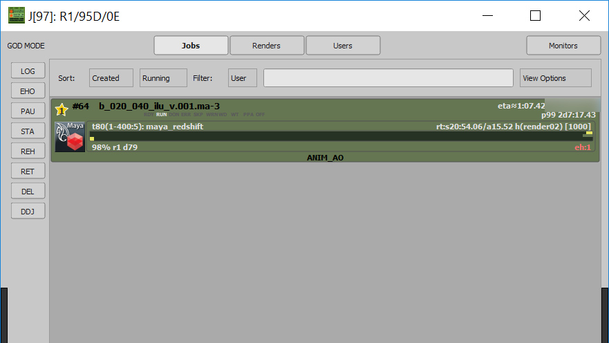

Hi there, I have an issue with the render queue.
Recently I had to reset the queue (everytime that the queue surpasses around 1200 jobs, it starts to do strange things like change done status of jobs)
Now I have a clean queue, but there are some render jobs that appear as if they are being rendering. I can't get rid of them, and I tried to delete them manually but I can't find where are they located. The thing is that it sometimes marks the render machines as being in use, so they don't take true render jobs.
How can I clean the render queue properly?
Thanks in advance.
PS: render farm and slaves are Windows 10 machines.

Hi Timuthai,
It's CGRU v.2.2.3, from released archive.
If I close and re-open afwatch, it stays the same. No change.

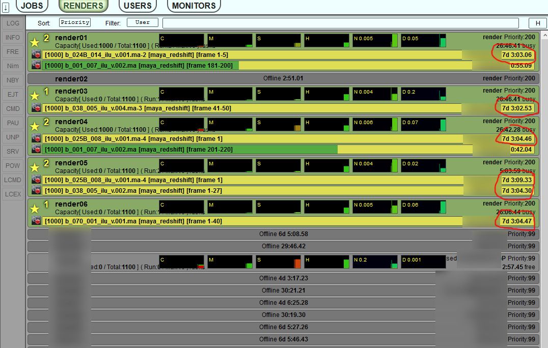

Re: Non-existent jobs on queue
And does WebGUI show the same?
SrTopete
Posts: 3
Joined: Mon Nov 05, 2018 8:54 am
Post by SrTopete »
Yes, it does.
(Render02 was down at the moment)
