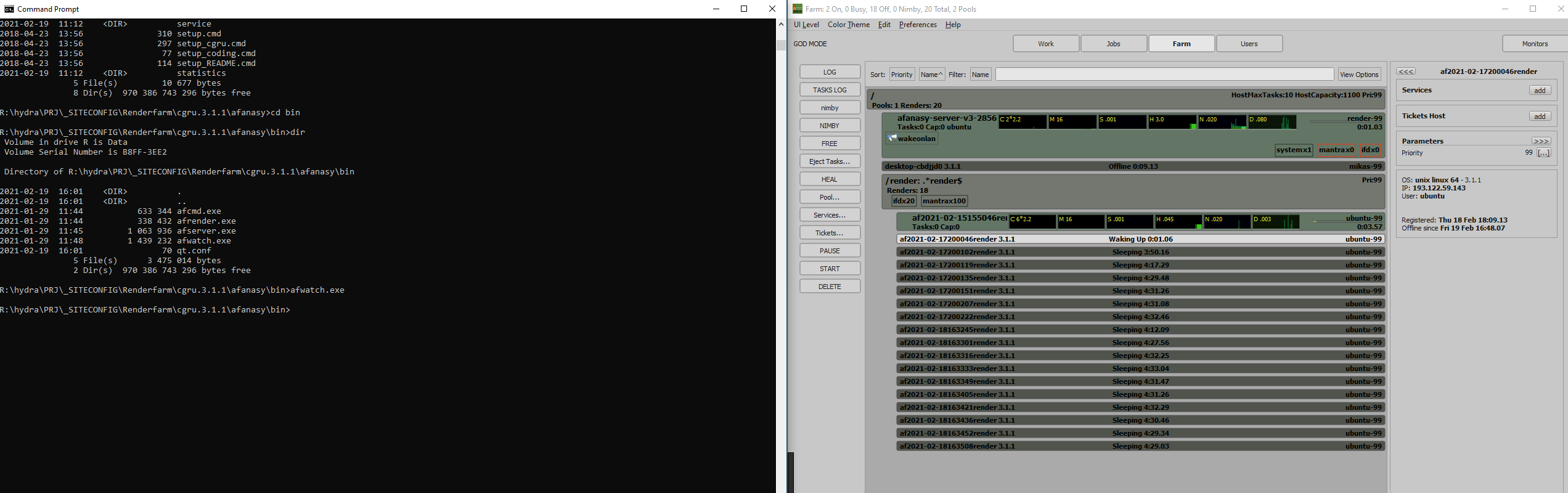

I ran afwatch from command prompt, but it doesn't provide any output there:
Screenshot 2021-02-19 165320.png (156.47 KiB) Viewed 17621 times
Any options I need to turn on while running it?

Re: Wrong client IP address
Sorry, it is only for Linux.
Windows version drops console.
Also you can look at web gui network logs. (left-bottom button with an arrow)
