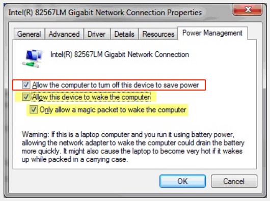

We were wrong. After disabling the "Magic Packet only" option something else is waking up the machines all the time after setting them to sleep. We thought that CGRU works now, but when we set the PCs to sleep they woke up within a minute later automatically. Turning off "Wake up on Pattern Match" in the adapter config seems to solve this now but now we just can wake up the PCs with AnyDesk or other tools.

Also, try to turn this option OFF:
