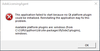

we are experiencing problems using Afanasy with the new release of Maya 2022.2

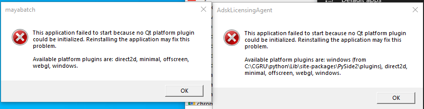

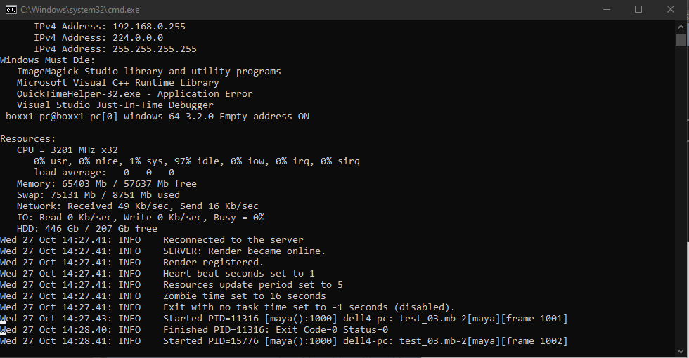

Since we upgraded Maya we were not able to launch the application from CGRU Keeper/Software/Maya and a distributed render from the Submit Job menu can be launched but it fails giving the same error on all hosts.
As an attachment you can find the output messages using Afanasy 3.2.0 and 3.2.1 respectively. Those messages appear either launching Maya or when a render is submitted.
Is there a way to fix this? Does anyone is experiencing the same problem?

Afanasy 3.2.0 + Maya 2022.2
Afanasy 3.2.1 + Maya 2022.2
AFANASY 3. + Maya 2022.2

- adskLicensing.png (13.09 KiB) Viewed 35030 times

It seems that Maya tries to use CGRU Python, and but it should use native, i think.
CGRU Python probably has other version and can not to contain some necessary plugins (dlls) that Maya needs.
Maya should not use CGRU Python definitely.
I guess that Maya Windows installation contains Python, am I right?
How do you setup Maya? How do run Maya and Maya render?
Try to unset PYTHONHOME environment variable in some script that setup Maya render.

thank you for your reply. We have tried to set the python path in the .env file of Maya with SET PYTHONHOME but it doesn't work. Actually we are a little bit puzzled.
Is there a way to reset the Python library Maya is going to use before its command/render is invoked from Afanasy?
As for the Maya installation we only run the setup file provided by Autodesk. Each host get the license with the Autodesk single sign on method.

Your Maya somehow knows, where cgru python is located, but Maya should know nothing about cgru python.
And i think that you should unset PYTHONHOME somewhere before .env file for Maya, as it can't even start.
Check you Maya and CGRU setup, there is some overlap.
Afrender has PYTHONHOME pointing to CGRU Python, as it needs it.
Then afrender starts Maya with that PYTHONHOME.
Somewhere in the middle PYTHONHOME should be unset.
