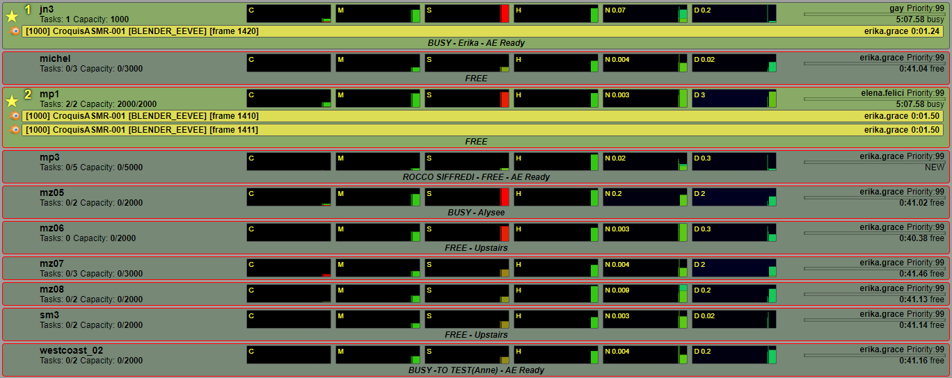

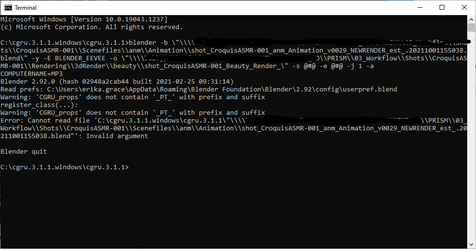

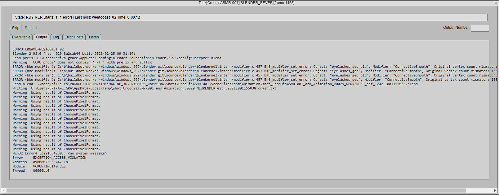

Here are some screenshots of the output and whatnot

Console task output says that Blender can open .blend file.
WebGUI task output says about some Blender specific errors. You can ask about this errors on some Blender forums.
