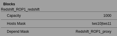

Heya Timur,
I've attempted to update my submit scripts with:
However, the block does not appear to error on any positive integer values [1..5] (I assume seconds as per the docs)...
Is there any indicator in the web gui that would show me that this parameter was in fact set? Other parms (such as host mask - see attachment) seem to be setting correctly, and are providing visual feedback.
G
if (rs_override_maxruntime):
block.setTaskMaxRunTime(rs_maxruntime)
G
- Screenshot-20210208162302-392x122.png (10.66 KiB) Viewed 66139 times
Rocky Linux 8.5, cgru 3.2.1
Re: max running time
Ach.
I'm passing "1" as a string -- when I do it correctly, everything works as expected.
... I'll show myself out ...
G
G
