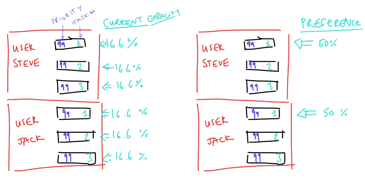

Hey Timur,
I've been reading the docs, and a couple of threads on here like "viewtopic.php?f=34&t=119" but I can't quite find the answer on possibilities
Currently the (default?) setup will distribute capacity across all jobs and users until they complete.
I'm looking to have afanasy solve jobs by proritising the completion of one job before starting the next, and hopefully distributing capacity among users.
Is this possible to configure?

On you drawing, on the left: user solve jobs by priority.
And on the right: by order - and this is the dafault behaviour.
So if you install Afanasy from scratch, the situation should be as you show on right.
May be you users STEVE and JACK set solving method to priority?
Or! You have tuned branches somehow. All STEVE and JACK jobs are in the same branch,
and that branch has JOBS solve type (not USERS).

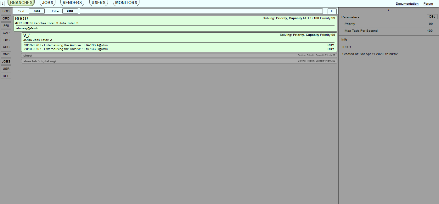

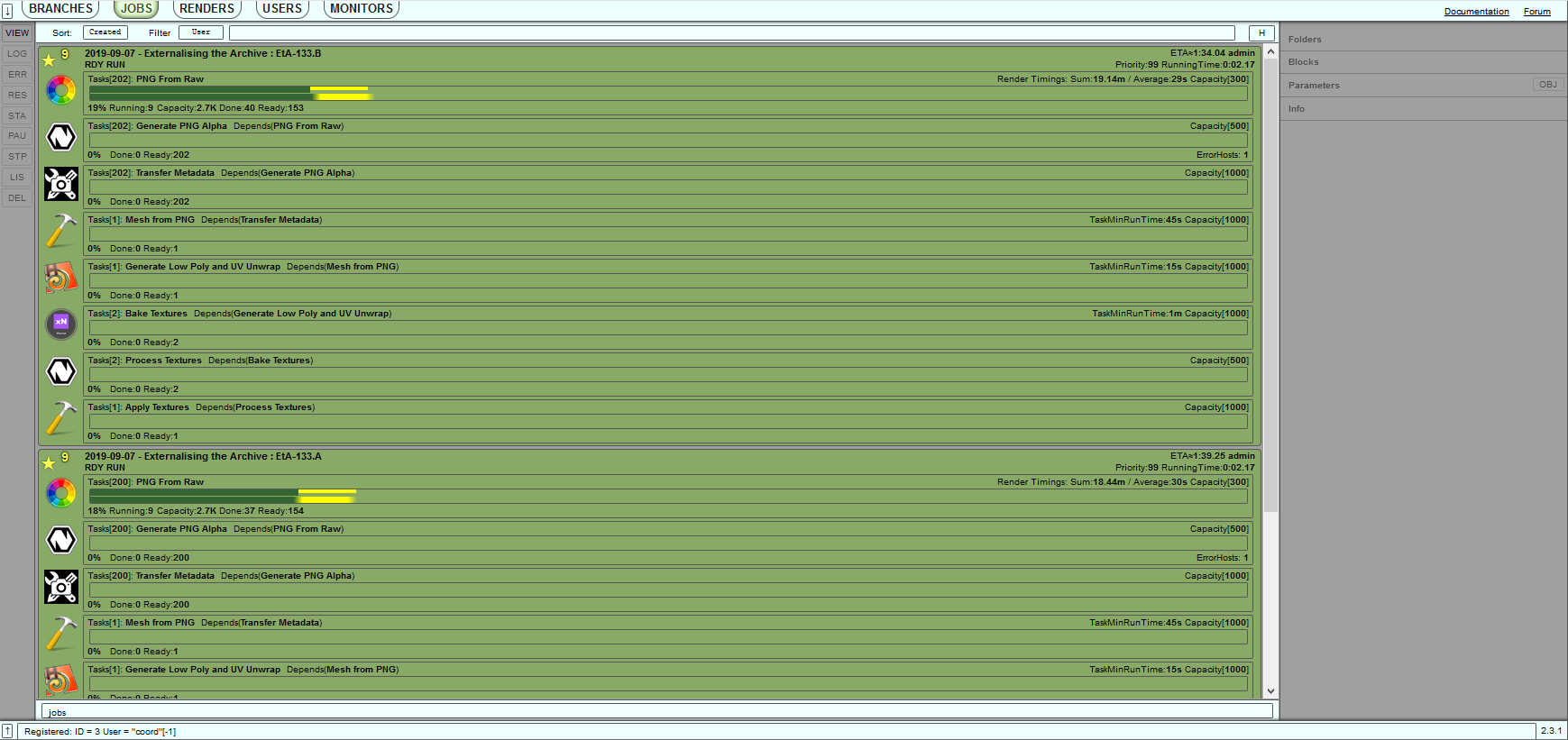

So, I don't have much experience with the branching setup, so here's a couple of screenshots how they are right now on a testing installation:
So at the moment, there's a single branch, with both tasks in, from a single user, but the capacity is being split across the job block/tasks.
Rich

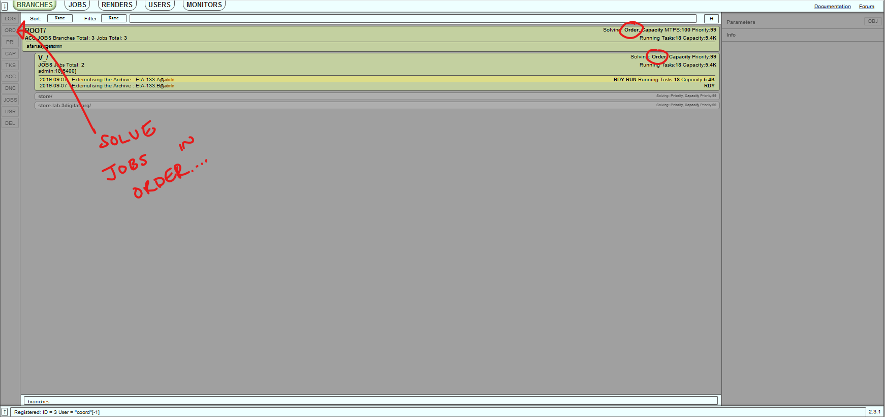

Aha!
So it's configured properly now!
For anyone else who comes across this thread, here's the button I'd missed:
Thanks again Timur, really helpful! I need to do some experimenting with branches I think!

Re: Job solving order - complete one task before starting next
Your branch V_/ has JOBS solving type. Set it USR (left panel button).
I should check Afanasy installation from scratch again.
May be there is bug, that branches under the ROOT/ got JOBS solving by default.
So you missed USR button, not ORD
With ORD and JOBS branches will solve jobs by order (and not users by priority as you want).
