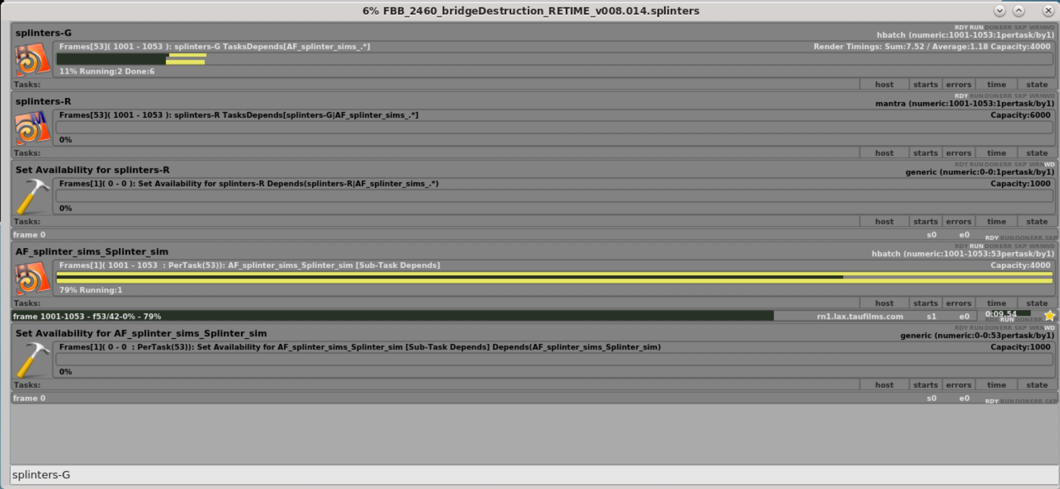

(see attached image) That top block is running when the expectation is that it waits for the sim (the 79% complete job further down) to complete. Is the intention that “allow subtask dependence” is used for this to happen?

Yes.
